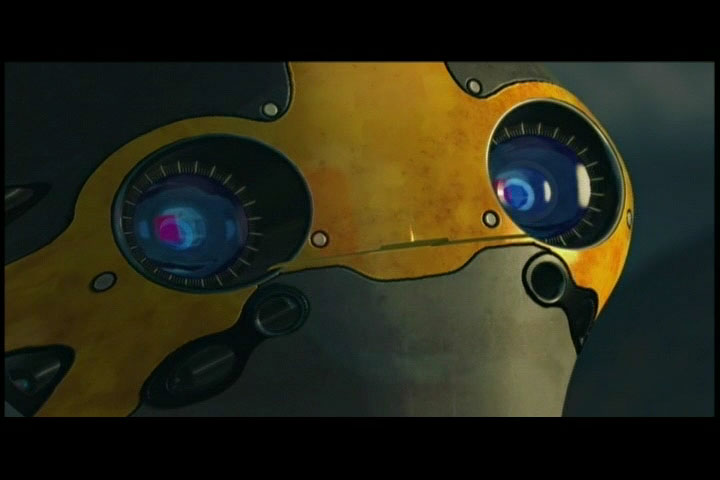

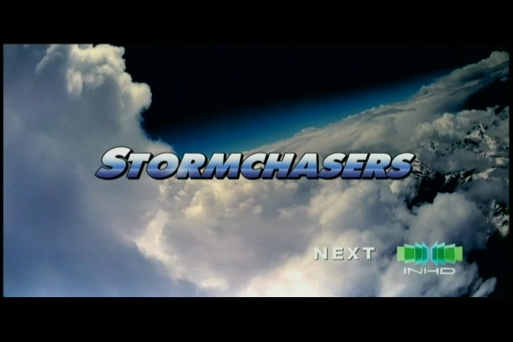

    Analog recording isn't so bad. Here is an example of what I get to a 480i DVD from the S-Video connector of a Comcast 6200 when the source is a 1080i HD channel. The S-Video connects to my Canopus ADVC-100 and then is realtime encoded to DVD MPeg2 with ULead Video Studio 8. Capture machine was a 2.4 GHz Celeron. Slower machines may need to cap DV first and then encode to MPeg2.
    You won't get this quality dubbing from the local DVR disk, just from the live broadcast.

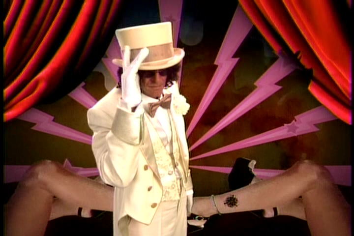

  22. Member
    Jan 2006
    i have a COMCAST Motorola box connected to my WIN TV PVR 150---here is a screen shot from the Howard Stern channel.....
    chesterfield,
    The problem with your set up is that WIN TV PVR 150 re-encodes original stream. With my set up it is just FireWire transfer from DVR hard disk to PC hard disk with no re-encoding.
