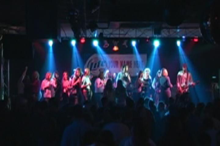

    To elaborate a little more on what Jim said, it's important that you pick an appropiate bitrate for the resolution. There's thresholds where it becomes too little or too much depending on the resolution. If your using a lower bitrate lower resolutions will produce better results. If you use too much at lower resolutions it won't produce a better video just a larger file. For example a resolution of 720x480 should be 4000 to 8000. If you go below 4000 the quality suffers quite a bit, above 8000 and your really not doing much but increasing the file size. Here's some example pics.
    720x480 @8000
    720x480 @3000, as you can see this produces heavy macroblocking and would be really bad to watch.
    352x240 @3000, as you can see the macroblocking has disappearred. The difference is that it no longer has the detail of the 8000 bitrate screenshot.
