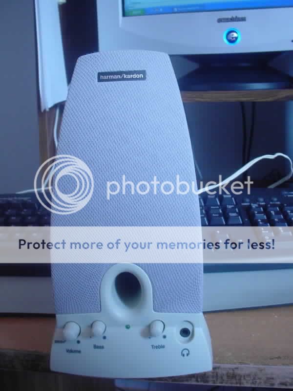

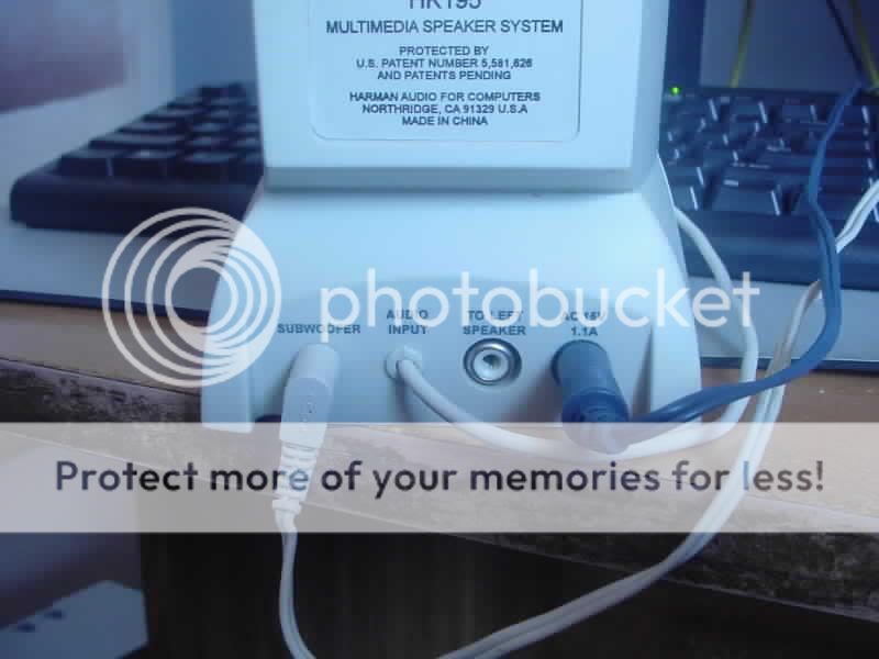

Here is what I'm using for the center channel - it is one speaker of a two speaker set from Harmon Kardon (HK 195):

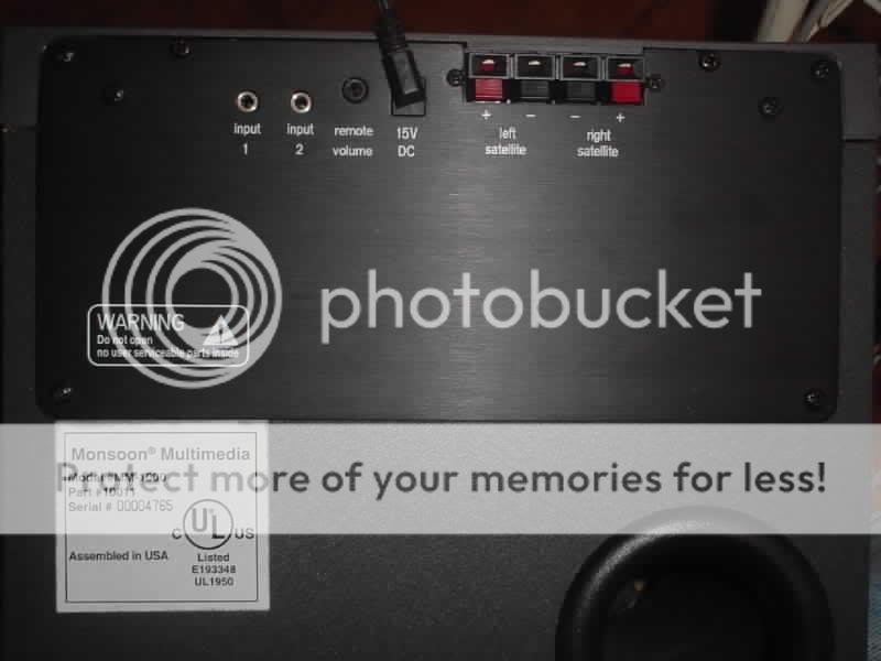

What I've tried to do is hook the audio input jack from the individual harmon kardon speaker to the center/sub output jack from the soundblaster. All I get is the bass in the center channel. However if I hook up a link cable to the subwoofer from the center channel I get the center AND bass going through the subwoofer. Here is the back of the Monsoon subwoofer:
What I can't seem to find is how to get the input to the subwoofer while splitting the vocal center channel to the center speaker.

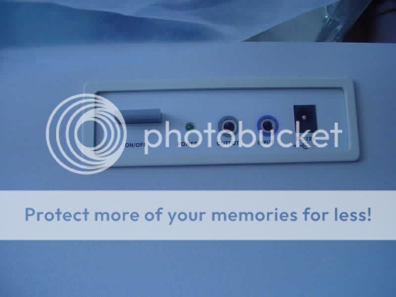

How I used to do it on my old sub was it had input and output jacks. I would hook the soundblaster center/sub output to the INPUT jack on the sub. Then I would hook the output on the sub to the center channel and it would be proper 5.1 surround sound. Here is my old subwoofer:

Creative cards do in fact output the subwoofer and center channels through one jack -- the same way it does both front signals from one jack and both rear signals from one jack. basically, the subwoofer is the "left" channel and the center is the "right" channel on this jack (or maybe vice versa)
you need an adapter.
go to Radio Shack.
their site is impossible to navigate, but here's what you need
http://www.radioshack.com/product.asp?MSCSProfile=745D84CBF04D14A48AA6FF9C89D722C0BA68...t%5Fid=42-2550
figure out which one is sub and which one is center and plug the subwoofer into the "input 1" on your subwoofer.
now you need yet another adapter.
though you didn't show it, I'm assuming your "center" speaker has the usual stereo plug on the end of it's "AUDIO INPUT" cable. get an RCA female to 1/8" female adapter and plug it onto the center channel wire from your Radio Shack cable and then plug your center speaker into it.
I know they make them (I have one), but I can't find it on their site.
if all else fails get one of these: http://www.radioshack.com/product.asp?MSCSProfile=745D84CBF04D14A48AA6FF9C89D722C0BA68...t%5Fid=274-330
and one of these: http://www.radioshack.com/product.asp?MSCSProfile=745D84CBF04D14A48AA6FF9C89D722C0BA68...%5Fid=274-1555

Thanks xylob. I've been experimenting using a ysplitter off of the center/sub output. However it might not be splitting it properly. I'll try to scrounge up a mini headphone STEREO splitter. Hopefully that will do the trick. Thanks
Kevin
EDIT - Thanks!!!! That worked. I used a headphone splitter jack that took it from the small headphone size to the rca plug and sent that to the subwoofer with one of those rca to headphone jack converters. All I got was bass!!!! Now I need an extra cable to hook up my center channel and walla - 5.1 again! Thanks xylob
