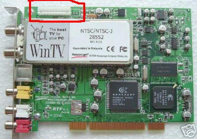

Okay i understand the part you are talking about, i have attached a picture so you can see the what im talking about.
The thing in red. If this is it would you have any idea of where i would find one of these cables?

A google for "pvr 250 sound" found this (from our very own reboot):
So it would appear to me that if you're using coax, the audio will come across but if you're using composite or S-Video then then you need to put the audio straight to your sound card.The PVR-250 only uses audio from the tuner portion, for TV.
If you're using composite video in, then audio must go to the sound card.
Set your capture software accordingly.
