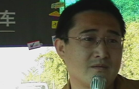

    im viewing the results on a tv - in australia.
    at the moment i am encoding someone speaking on a microphone at the front of a bus. But i want to encode a movie i put together of a trip overseas.
    By pixilated i mean the picture doesnt look 100% clear or smooth, its a bit grainy in places, mainly when movement occurs. Its not like a dvd you buy from a shop.
    Using 2pass VBR, 10bits,
    Average Bit rate - 7000
    Max bit rate - 9000
    min bit rate 2000.
    Im not sure how to do screen shots...

    used windows media player.
    its and mpeg. would it help if i did an AVI, for comparison?
    i didnt do anything to the settings in media player. when i converted im pretty sure i used interlace

    the AVI, this was the closest match i could get to the first screencap

    the last pict is a screen shot on the AVI. the second last is a mpeg screen shot

    The major problem with that picture is excessive dynamic range (white to dark) for a 8 bit video system. It looks like the camera made the right decision to expose the foreground properly and let the background go into clipping. The result is the background lacks any gray scale to moderate edge artifacts. This is an extreme case sample.
    Be specific as to which areas of the picture are concerning you. You have a better view than these stills give us. Most problems with MPeg show up in motion.
    If pros were shooting that scene they would have put a bright keylight on the subject's face and probabbly blocked that background. That is what they have do to make video fit into 8 bits. If they couldn't avoid the background, they would expose it by switching in a neutral density filter and then use heavier lighting on the subject.
