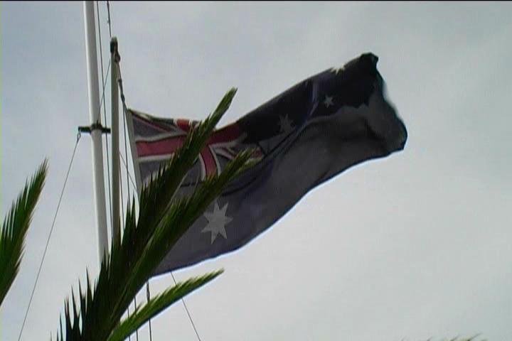

I encoded a DV AVI with TMPGEnc default "DVD (NTSC)" template (basic settings: MPEG-2 720x480 29.97fps CQ 65, Layer-2 48000Hz 384kbps), the following is a screenprint from that:
There's a slight blur at the free end of the flag where's it was whipping around in strong winds, but the rest is really clear. The clip was played and the screen print captured in PowerDVD.
Just so you know it's possible, to let you know what you can achieve and to give you hope (hopefully)...There is some corner of a foreign field that is forever England: Telstra Stadium, Sydney, 22/11/2003.
