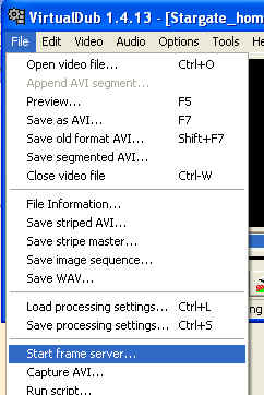

Launch Virtualdub , then
Locate you video file , and when loaded
Then hit the first of these two buttons
Then

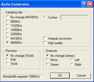

Then hit the second of those two buttons
Now
Followed by
Here it should be set too

Then you get this

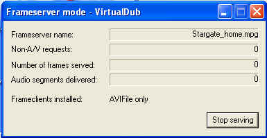

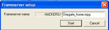

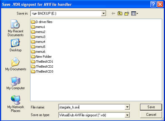

hit start , then
Must include avi extension
Hit save and you is here

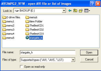

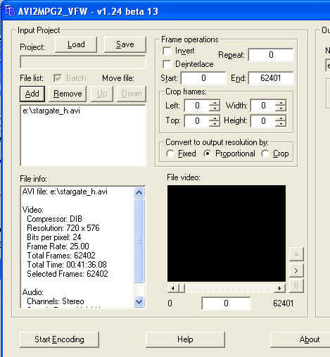

Now you want to run avi2mpg2_vfw (bbmpeg)
Then hit ADD button
Locate that avi file you just started
Hit open , and you is here
Hit Start Encoding

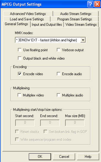

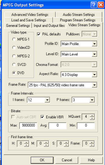

Then in the next window , hit that Settings button ,and for pal do what I have
Now go here and do the same thing as I have done
Hit Ok button , then Start button , and wait till encoding is completed

Beaware that when frameserving , it wont work if the file's name contain's character's that are not numerical , or alphabetical , it will allow for "-" , and "_" , but not other characters .
My advice here is before you start , if the name is over 8 characters long , please rename your file to eight characters long only .
