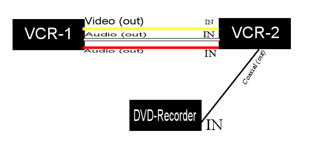

If you want to get it done without buying this, Try running the VHS from one VCR into another VCR then into the DVD Recorder. This has worked for me many times.
You might need to use the coaxial cable this will cause quality loss. -

When I do it I have to hit Play on the second Vcr so it "Kicks in" the "out put" then I hit stop and then play on the other. Then Record on the Recorder,I have never ran into one that wouldnt work,But Like I said sometimes you have to use the coaxial cable.
Let me know how you make out. -

This may not work because the Macrovision signal has to pass through the second VCR and that alone will probably distort the picture. Macrovision is also carried in the RF signal that goes through the coaxial cable. Still, depending on the VCRs used, it might work. The Macrovision signal only effects about 85% on VCRs.Originally Posted by canadateck -
Has worked for me 100% of the time,No loss in quality other then what you would get going from Coaxial. or passing through two tuners.
Will it work for everyone dont know.
I have tested this with different VCR's. And all the VCR's see Macrovision,but I was able to get by it with this method. -

You played it out one VCR into another VCR then out through the Coaxial into the Recorder?
also try playing it in through the front inputs and the back one see if it works.
Tried BOTH front and rear inputs on Recorder....tried switching VCRs from one to another (different pass-through one) Used all composite connections for Video...still no go. Maybe the Panasonic DVD Recorders just won't do it. I guess I am destined to watch this on VHS
And I really thought your idea would work canadateck...oh well, it was worth a shot! -
Thx canadateck...I'll give it a shot later today and let you know...nice diagram BTW!
