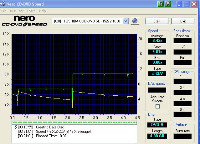

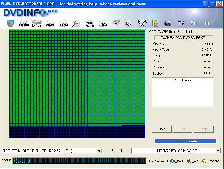

  3. I had 100 TY's arrive last Tuesday from Supermediastore. I tested one the same way you did with DVDInfoPro. Here are the results,

    Looks identical to your disk. Here are the burn speeds,
    and the error results,
    I do not think the problem is media either or that these are fakes. I have fake 02's and they do not work well.
