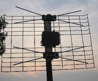

You are a bit too far away for an indoor antenna.
Something like this mounted outside would solve your problems immediately.
http://store.electrogalaxy.com/zengemdtv1.html
If space is tight, this style can be easier to mount.
Ed

That one is 3ft long. Many place antennas in the attic. Rule of thumb is you need twice the antenna gain for attic mounting.
Are you in an apartment? You could hang an antenna like the one above below a window or place it on a deck.
http://www.tvantenna.com/support/tutorials/atticantennas.html -

If you have room for it, the larger Zenith Gemstar should give you a considerable boost. It will be more difficult to point to Sutro and won't get NBC 11/12DT in San Jose. Use the small antenna for KNTV NBC.
I have a DVICO and one of those small Zenith antennas indoors and I get a marginal signal from the tower that's about 10 miles away, clear sight. Even with a 20DB amplifier the signal is weak.
I would say don't bother with one of those little antennas. Even a ~3x3 foot screen antenna indoors would be better. That's my next move. I'm in an apartment, 2nd floor and no windows, no way to mount exterior to point toward the towers. -

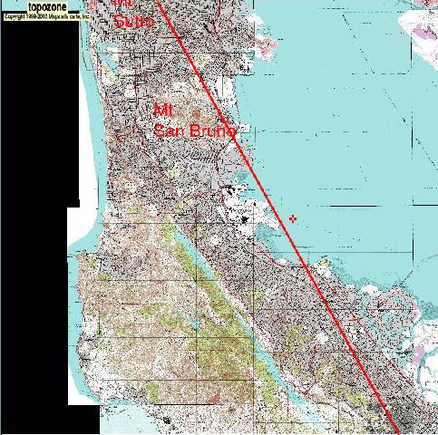

Originally Posted by rotuts
No. CA man here,
As said on the other thread, power needed goes up as the UHF frequency goes up. Palo Alto has always been a difficult place to receive from Sutro. SF. You just need a larger antenna to solve your problem.
You are shooting over the side of Mt San Bruno from where you are. Not much signal gets through.
I got tired of running a indoor antenna with a amplifier and still getting a marginal signal. What I meant by a 'Screen' antenna is a UHF bowtie type flat antenna, similar to the pic that edDV posted. I just ordered a Channel Master 4228. It's large for inside use, it's 40" X 36" X 4" deep. I may use it as a room decoration or stick it in a back room or the attic if I can get access.
