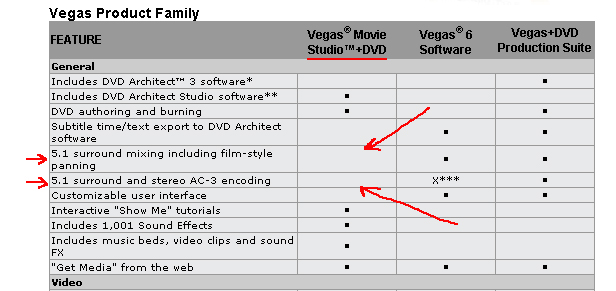

  14. Member Cunhambebe's Avatar
    Mar 2004
    São Paulo - Brazil
    thankyou very much
    -You're welcome.
    just a quick question,
    what does this mean "One thing is certain: you'll not be able to render to AC-3. "
    Look at the Comparison Chart, please.
    Jul 2005
    Malaysia
    ahh i see!!!!! argh! so mad!
    okay will try those links, and just pray that there is a way somehow, im just really upset that i havent been able to figure it out.
