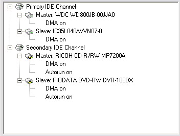

Hi there
Here is some info about the computer. I'm sorry I meglected it before.
I hope this helps some more.
John -
Go to the manufacture's website and download the tools for setting up new hard drives .
One of them will give you information regarding how to setup those jumpers correctly , dont take the word of those printouts stuck on the top of them , western digital drives printout is total wrong , and maxtor wouldnt be far behind them .
Sounds like the drives controler isnt fully doing its job , just like a couple of western digitals here .
Try setting the jumper to cs and not master or slave , and try the tools out again , as I bet its the controler gone on holiday permanently .
Setting them to cs should bring that drive back online , maybe for years , or maybe long enough to recover data only . -
