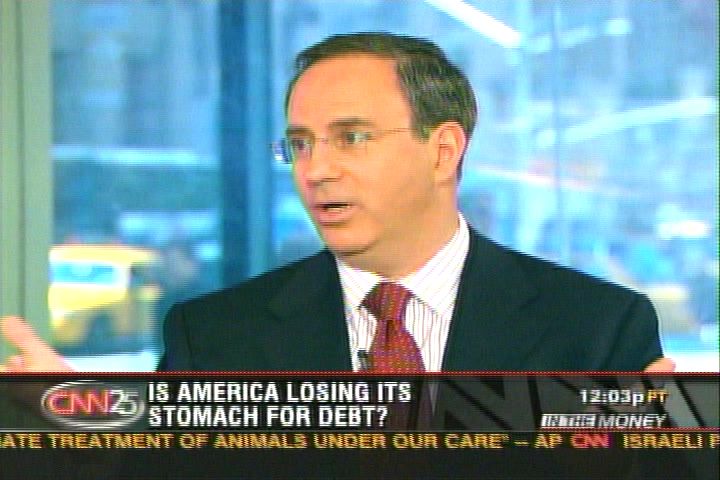

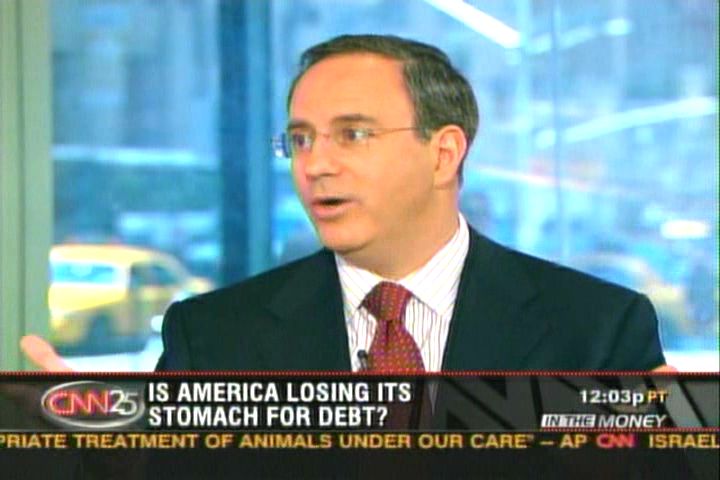

I did some experimenting because I wasn't sure that a 10fps AVI would convert correctly to DVD with VSO DivXToDVD and found out that it will.
What I did find out though is that the quality from an M-JPEG conversion looks pretty bad so the way that I discovered to fix both the video quality and mono audio is to open the files in VirtualDub, choose the Deinterlace filter > Blend Frames under Video (choosing Xvid compression with 2000 bitrate which will cut the file size of your VOBs in half) and Audio > Conversion > 48Hz x 16bit Stereo and save the new AVI and then convert to DVD.
You didn't say whether these 30 second clips were part of a whole or not. If they are, you can append them all together with VirtualDub.
If they're not, you could use job control and the settings above to batch convert all the clips and then convert to DVD with VSO DivXToDVD.
Here are screenshots from the Test VOBs in PowerDVD.
M-JPEG/Mono to DVD
M-JPEG/Mono to XviD/Stereo to DVD
