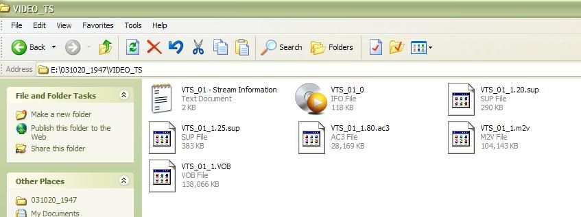

I ripped a few DVD Chapters along with the audio and the subtitles using the DVDDecrypter. Finding the subtitles coming up on the screen before the vocal even starts, I decided to edit the subtitles and then synchronize them correctly.
So, following the guides given by Paddington, TheMatrixx and Erik Vullings(all these guides are almost the same), I demuxed the .IFO and .VOB files to get one .m2v and .ac3 files each, and two .sup files.
Here's a screenshot of the ripped files on my HDD:
Further following the guide(s), they stated that these .sup files can be synchronized and edited using the Subtitle Workshop and then saved as *.srt files or *.sub files, and thereafter can be put back together(i.e., audio, video and subtitles) using ifoedit or rejig.

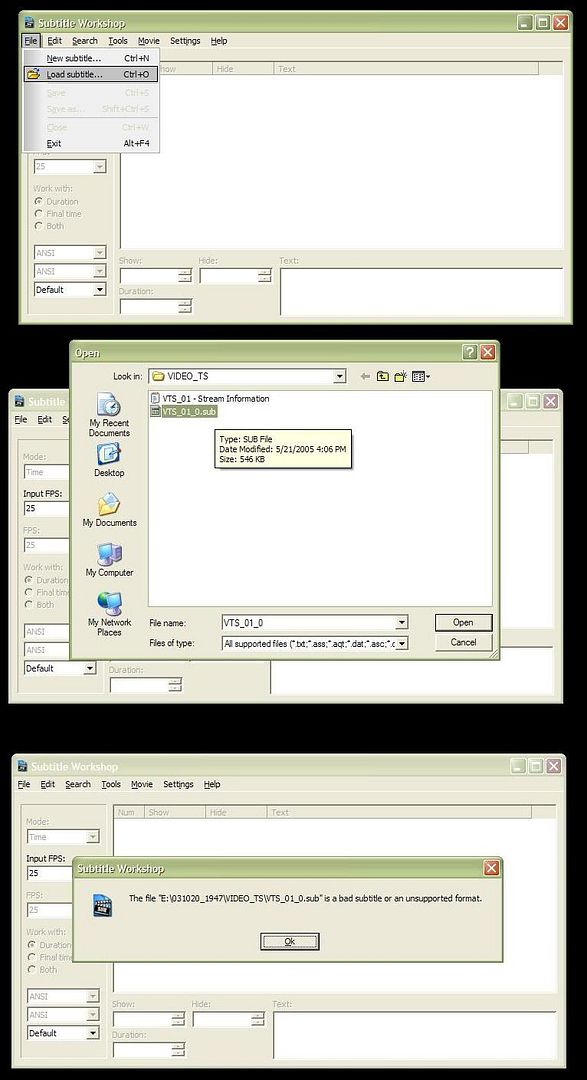

In order to convert into *.srt or *.sub files, the *.sup files should first of all open in the Subtitle Workshop software. This isn't happening. The .sup files(neither are the originally ripped .ifo files) are not supported by Subtitle Workshop for the purpose of being opened and edited. So, how the hell can I convert them into *.srt or *.sub formats without firstly opening them. This is a very confusing(perhaps wrongly directed) guide.

But, in order to edit the subtitle files i.e., *.sup files(extracted by VobEdit), the Subtitle Workshop must open them first of all, which it doesn't do. So, the question of editing and saving them as *.srt or *.sub doesn't even arise.
Now, my question is how do I edit the subtitles(which I firstly ripped and saved as .ifo and .vob files on hdd, then demuxed them into .sup files using vobedit) of my ripped DVD on HDD using subtitle workshop or any other software that u want to suggest me.[/i]

even after ripping the .ifo file into .sub file using vsrip, the Subtitle Workshop isn't accepting that file too. pls look at the screenshot below:Originally Posted by Baldrick
is it b'coz i ripped only a few chapters of the movie ??
coming to u'r sticky topic, it's a doom9 link to the subrip guide, which i already went through. this website gave the process about subrip v0.81b, but provided v1.17 in the site links for the subtitle packs. there r ofcourse other versions provided in the subrip's main site i.e., http://zuggy.wz.cz, but, none of them resemble the working process described in the doom9 guide, coz, the guide describes an entirely different(i guess an old) version, which i think is not currently available for download in the site(s). -

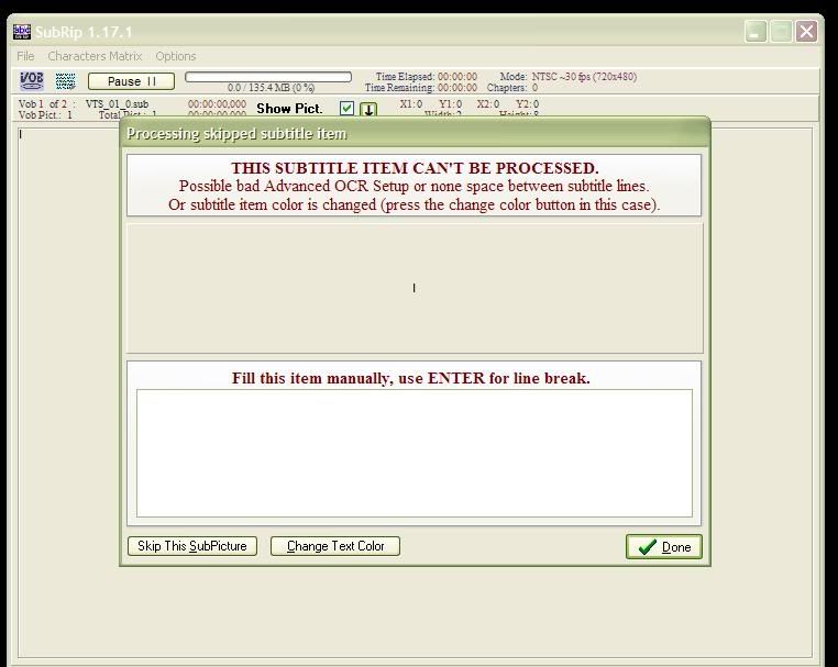

you must use subrip or subresync with sub/idx also. the subs are images and subtitle workshop does not support them.
In subrip:
File->Open vob(s)
Click Open ifo and open the idx
Click start -

and if you are open a ifo from the dvd video_ts folder you must open the vts_xx_x.ifo that belongs to the main movie. just try open different ones.

To convert the SUP file to and .srt file, I use DVDsubedit. This uses OCR (optical character recognition) to turn the SUP file (which is really an image) into an .srt, which is a text file. Then you can use Subtitle Workshop to edit your subtitles. Once you're done with the edits, you run it through Subtitle Creator to re-save it as a SUP file, which you can then use as your new subtitles when you remux.
Good luck -
If you can figure the delay the easiest method to correct it is to use SubtitleCreator for the job. No OCR necessary. Open SubtitleCreator and go Tools->Manipulate SUP and VobSub. In the bottom right of the new screen "Open Sub" and scroll to and open the SUP file. In the bottom right hit the "Delay" button and add in a delay, "Apply" it followed by Save Sub. Save the edited SUP file under a new name, do the muxing and test it out. If it's still off, do those steps over again or (probably easier and faster) do the final delay adjustments using DVDSubEdit.
For other editing (like fixing bad grammar and the like), SubtitleCreator claims to be able to OCR a SUP file to SRT, but I've never used it for that. Like most everyone else I open either the IFO or an IDX/SUB (the IDX/SUB can be instantly created in SubtitleCreator, from the SUP file) in SubRip followed by the OCR.
