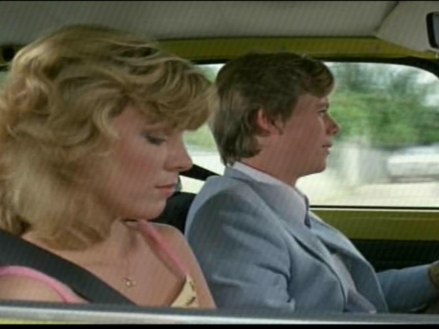

I bought and set-up a Kworld V-Stream Xpert DVD Maker USB 2.0. I have it set up using S-video from the digital cable box (Comcast Motorola box) to the USB capture device to the 2.0 PCI card.
The problem is the video has these slanted lines in it no matter what software I use. The broadcast as shown on the TV is fine, but the capture shows these lines. below are pics as examples of the lines.
I changed the set-up from the the source being the Cable box to the VCR and get the same results. I changed the crappy software that came with the capture card to VirtualVCR, but the lines appear when using that software too.
The PC I am using is a P4, 2.4G, 512MB RAM, NVIDIA GeForce4 Ti 4200 (with tv out) card, Digital LCD attached to digital connection on video card, and running WindowsXP Pro.
Does anyone know what can cause these lines? any ideas of what I can doI can do to make these lines disappear?

Sorry, I didn't know the tags needed to post pics. I should have read the instructions first.
The lines are slanted as shown in the pic shown in the edit of my original post.

I agree, its some kind of analog interference. If you don't see it on a monitor using the same S-Video cable, then it is happening in the capture device.
Try moving the capture device away from monitors, the computer and other sources of RF interference. -

So far I think the inteference has been isolated after the VCR. I disconnected everything, then connected RCA composite video from Cable box to VCR, from VCR to TV. No lines appeared. I disconnect the TV then connected the same RCA to the capture device. the lines again appeared, and was much darker than when I used the S-Video.
I repeated the same procedure with the S-video. No lines when the S-video was connected to TV, but the lines shown in the pic above reappeared when connected to the capture device.
So it does not appear to be a problem from the cable box to the VCR. it seems the problem could be going into the PCI card. The PCI card is located next to the Video card in the PC. could this cause inteference?

thanks to everyone for their comments and suggestions. I have tried everything, but still have the problem. HOWEVER, I have been able to rule out many things and it appears the problem is isolated to the PC.
I disconnected the capture card USB plug from my PC and connected it to my laptop. Ran the program and absolutely NO LINES!!! the capture is perfect!!! So it appears the problem is not in the cables, or the capture card.
I opened the PC case, blew out all the dust and relocated the USB 2.0 PCI card. put everything together, and still get lines in the capture when using the PC.

You have a power issue. Ripple is getting through to your card, either from the DC power lines, or the grounds. You didn't have this problem on the laptop because I'm assuming that it was battery powered - thus no AC ripple current and no ground loop.
From your experiments, I would suggest that you try to minimize your ground loop currents.

ok, I think I finally figured it out!!! First, the laptop was plugged into the same surge protector as the PC. So I once again tried capturing on both the laptop and PC. laptop no lines, PC once again lines.
Then for some reason I switched the PC video from the digital (DVI) to the VGA port on my video card. guess what?
SUCCESS!!! When using the VGA port, the picture is perfect, no lines, no problems at all!!!
