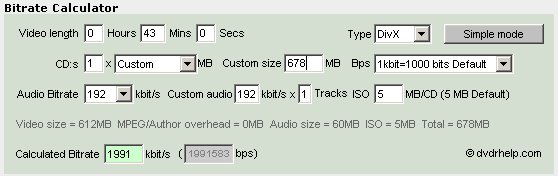

Size = running time x bitrate,
so it stands that if your running times are the same, your size variances must be being caused by variances in the bitrate(s).
I just used a bitrate calc and got the following:
This indicates that your 678MB files are the right size and are close enough to expected given your bitrates of 2000kbps for video and 192kbps for audio. It's the ones that are not 678MB where I suspect your settings have got messed up somehow.If in doubt, Google it. -
