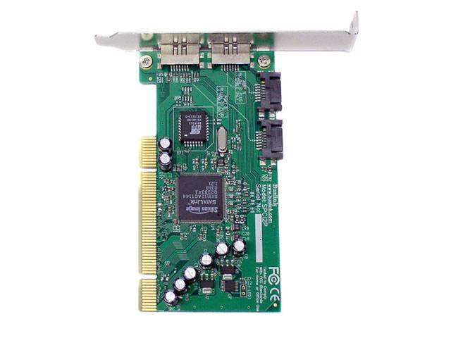

    Another option: add a Serial ATA card:
    and put a new SATA drive in a 5.25 bay with some drive rails:
    USA
    I would agree with Forum Troll's suggestion as the best solution and keep your DVD-ROM. Or you could also use a PCI IDE controller if you want to stick to IDE HDs. You can use the rails as he mentions or fit it into the floppy bay if there's room.

  4. Thanks.
    Forum Troll: Why do I need Serial ATA card? All three hard drives are PATA.

    Serial ATA has a faster data transfer rate than current PATA drives. I would keep the DVD-ROM drive to use for reading disks, and only use the burner for burning.
