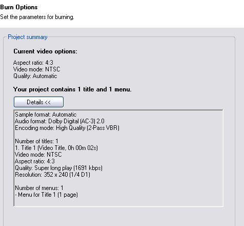

    NeroVision3 defaults are "High Quality (2 pass VBR)
    Next produces this??????
    Yikes, this is probably because I was capping an ATI AIW card.
    Tell us what your project settings show.
    As you can see, mine went for very low quality.
