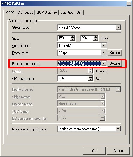

After loading your template (either DVD (PAL) or DVD (NTSC), depending on your area of the world), click the "Settings" button:VBR
Variable Bit Rate - the bitrate can vary at any part of a single video or audio stream. VBR can is used to increase bitrate during high motion scenes in a video or to reduce overall file size. DVD MPEG-2 video is often variable bit rate. Also see CBR (constant bit rate).

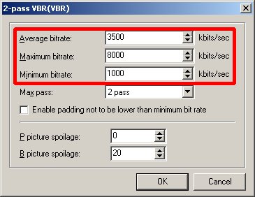

Change the "Rate Control Mode" to "2-Pass VBR (VBR)", then hit the "Settings" button:
Then input the values I suggested in the appropriate fields:
OK your way out.

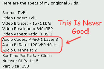

And I have no idea how they encode these files since no program that I own will encode a VBR MP3 / XviD. -
Besweet or Belight can do itOriginally Posted by DarrellS
Most probably use Besweet either via the Besweet GUI, Belight or through AutoGK or Gordian Knot.
It's probably a good idea to extract the audio first (guide here) because TMPGEnc is known to have problems with VBR MP3 audio
If in doubt, Google it. -

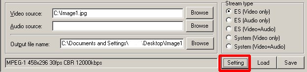

If using TMPGEnc and ffmpeggui, set TMPGEnc to do ES (Video Only):Originally Posted by Born Slippy
... and then load your original AVI into ffmpeggui.
You'll get a M2V file from TMPGEnc, and an AC3 or MP2 file from ffmpeggui. Then you can use your authoring software to join them together, or TMPGEnc's MPEG Tools to do a Simple Multiplex.If in doubt, Google it. -
