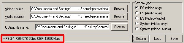

MPEG-1 is limited to 1856kbps to remain compliant with the DVD standard (@ 352 x 288), but in terms of PC-only playback, the sky is the limit in terms of how high you can push the bitrate.Originally Posted by shumisha
I just did a sample MPEG-1 720 x 576 encode in TMPGEnc @ 12,000kbps with no hassles:
If in doubt, Google it. -
