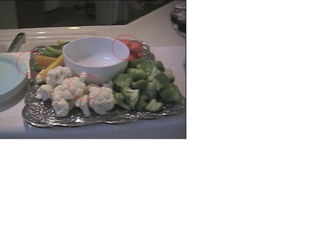

    My first post so please be gentle. I searched around a bit but didn't find any answers to my specific questions. I mainly just want to confirm my understanding of this whole process.
    1. Is there any way to open up captured DV files (from a digital camcorder) in VirtualDub *without* installing any VFW codecs assuming XP is the OS? If not, is the Panasonic DV codec the way to go?
    2. I have captured (copied) some DV footage from my Canon Elura to my PC using both Nero and WinDV. I captured the video as type 1 DV, extracted the AC3 audio using ffmpeg and opened the AVI file up in VirtualDubMod (w/Panasonic DV codec) which of course gave me the "audio can't be loaded" message. All fine. However, when I step through the DV footage in VDM, I noticed the footage has interlacing artifacts... Like so...
    My question is more of a confirmation as to why this is happening. The footage was shot interlaced so the two fields are slightly timeshifted. When the footage is digitized the two slightly different fields are merged into one progressive frame. Is this correct?
    3. The strange thing is that if I open my DV Type 1 AVI file in Windows Media Player the footage does not have the interlacing artifacts. Does WMP auto-deinterlace?
    4. An even stranger thing is that if I open up Nero Vision Express and load the AVI file into a timeline *and then* play the file through WMP the interlacing artifacts appear! If I close Nero and replay the AVI file in WMP the interlacing is gone. What is going on?

    You need a viewing program to accept interlaced video. Not sure if WMP does this. I use Power DVD which I know can properly display interlace video.

    WMP is pretty poor with interlaced footage, PowerDVD handles it much better so will give a more realistic image. However, when you come to burn this footage to DVD and play it back on a TV, you will not see any of the interlacing artifacts as a TV is intended for viewing interlaced footage. A pc monitor isn't so although it may look grim on your monitor, it will be fine once it becomes a DVD and is played on a TV.

    Interlacing ...
    The only time when you want to apply some kind of de-interlacing algorithem
    to your source is for when you want to watch it on a PC monitor.., otherwise,
    perhaps for experimental purposes.
    But, in most cases, you want to leave it as Interlaced, and proceed to encode
    it. When finaly played by your DVD player and TV set, everything will be
    alright (IOW, progressive looking) and enjoyable.

    Capturing your screen area (aka, video window) ...
    Inside your editor (ie, vdub) when you are at a frame, press Ctrl+1 and
    copy that to your graphics app. Any app will do.., even MS Paint.., and
    save as whatever bitmap format is available to your setup. You should be
    able to redo that pic above, whith these steps I just laid out
    Good luck thus far.
