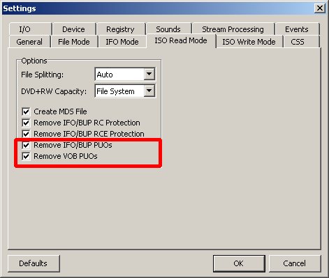

Without trying to sound like a DVDDecrypter fanatic ... not that there's anything wrong with that, mind you ...Originally Posted by samijubal
... you can set DVDDecrypter to remove PUOs ...
If in doubt, Google it. -
I take it PUOs are what forces you to watch the "FBI warning" at the beginning of EVERY movie?
Prohibited User Operations (PUOs) are the things that you can't skip using the >> or 'Next' button, such as the FBI warning, any studio messages, etc. etc. Depending on your player, you normally get a red circle with a line through it, or a hand with a line across it, indicating "No, you can't use buttons here", or something similar.
