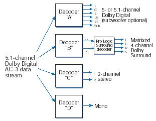

"Dolby Digital (AC-3)
Surround sound technology that delivers high-quality digital audio for up to 5.1 discrete channels (Left/Center/Right/Left surround/Right surround/Low-Frequency Effects). The five speaker channels produce a directional and more realistic effect and the Low- Frequency Effects (LFE) channel (usually reproduced through a subwoofer) can often be felt as well as heard. Found in: DVDs; DVD players; broadcast programming in HDTV, digital cable, and (DBS, DTH) direct broadcast satellite (DirecTV/Dish/Sky TV); PCs; Microsoft Xbox game consoles; digital TVs; automotive DVD-Audio/Video players; automotive video, networking and home audio/video receivers; film soundtracks encoded in Dolby Digital."
It takes the right decoder to recreate the five channels from the two.

P.S. CS has similarities to Dolby Prologic which is also a matrixed analog system. In theory, one could encode a Dolby Digital datastream with 5.1 channels and decode to a CS signal, just as Dolby's figure above shows Dolby Digital can be decoded to a Prologic signal.
In my second comment, I confused the matrixed Dolby Prologic with the new Dolby Digital. Dolby Digital is a single datastream which can be encoded with up to 5.1 channels of data but if the ES10 says two, then I would have to say the Dolby Digital datastream is only encoded with two channels. -

P.S. Both CS and ProLogic are analog, matrixed systems. It is the conversion from analog to the datastream that cannot support the matrixed signals so they are lost. The only way it could be done is if the reccorder did like the Kenwood and decodes the CS signal into six channels, then the Dolby Digital encode could contain 5.1 channels. This is how the Dolby diagram above shows a down-mixed ProLogic signal being created. They could do that with CS too if the decoder were available. The Dolby Prologic matrixed signals are lost for the same reason. The Panasonic cannot encode a 5.1 channel signal however -
