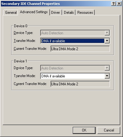

  5. Thanks for the reply. Both say "DMA if available" for the "Transfer Mode".
  6. Originally Posted by Drooling Dog
    You're missing an important bit of data - what is the "Current Transfer Mode"?
