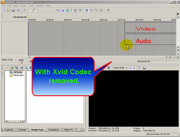

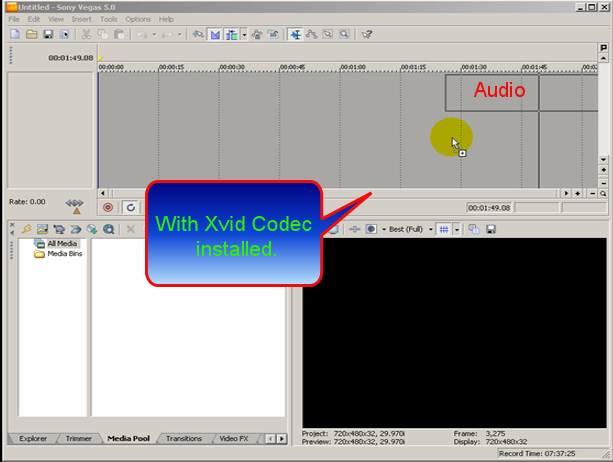

Here's a snapshot before the removal of the codec.
------- here's one after the removal-----------
