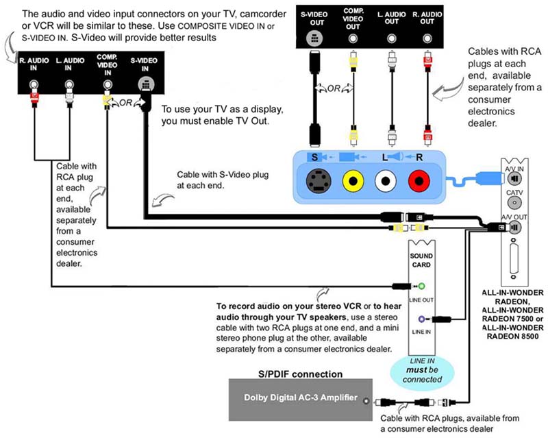

    Here's a better picture. I spent enough time making it in Photoshop so I figure I might as well post it.
    Apr 2005
    Southeast MI
    Originally Posted by Webster
    That because they print it on 2 different pages.
    They print it on two different pages -- WITH A DIFFERENT SCENARIO TITLE AT THE TOP OF EACH PAGE...
    Give me a break...
    You're right, though. I just interpreted it at first glance as page 21, "here's how you connect a VCR to record" and page 22, "here's how you connect a television to the output" -- it looked like two separate uses for the card. And then they sneak in that bit about the line input on 22 -- "oh, by the way, don't forget to connect THIS..."
    I think the illustrations could have been clearer. That's my story and I'm sticking to it.
    Edit: yeah, had they shown it the way DarrellS does here -- that makes much more sense to me.
    Now you can see why I used the word "stupid" in my topic -- I had a gut feeling that that's how I'd feel by the time we got done talking about this...
    C.K.

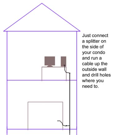

    Here is a picture of your condo showing how to run cable TV to your video card on the second floor.
    Apr 2005
    Southeast MI
    Won't work. The wall that it would have to be done on is internal (the condos are attached).
    And if I ran any wires on the exterior of my unit, the association would string me up...
    I do have phone wiring on/in the wall in question, though, so there is the possibility that I can snake coax along the same path that the phone wiring follows, and there will be holes through the framing where needed. It might not be a bad idea for me to investigate this in any case, as I may end up going on broadband someday (I'm on DSL now).
    edit: I found a seller for the output cable I am in need of, and ordered one... I'm going to try out the internal connection between the AIW and the sound card in the meantime.
    C.K.
    Nov 2002
    I'm not sure if there would be enough room to pull a coax through the same hole but it's worth a try. You might have to drill another hole and it takes a special kind of drill and bit. You might think about going through the sheetrock in a closet or cabinet where it wouldn't be noticable.
