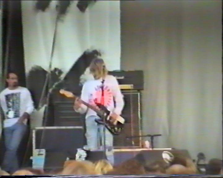

here are some caps
TBC ON ,it dropped about 2 or 3 frames every sencod , i hate it but i have to capture with this turn on , the quality is 100 times better than capturing with it off.

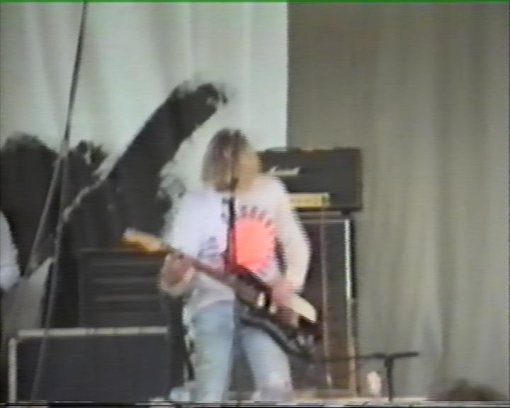

You can see a green line at the top
