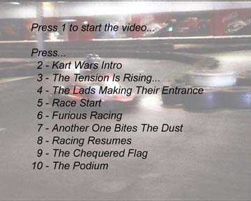

Here's a shrunken example from a go-karting VCD I knocked up for people at work:
This can then be turned into an MPEG still using VCDEasy and then used as the menu for the VCD.
You can then set 1, 2, 3 ... 10 as chapter points in the footage using VCDEasy. I've done just that using a guide from this site. I think this was it:
www.videohelp.com/forum/userguides/84327.php
Enjoy...There is some corner of a foreign field that is forever England: Telstra Stadium, Sydney, 22/11/2003.
