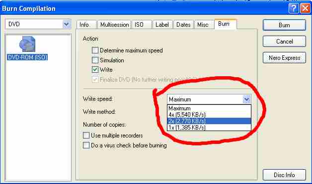

  6. How do you adjust the speed in Nero?
  7. Member steveryan's Avatar
    Jan 2003
    Manchester
    When you're ready to go hit the burn icon and you'll get this screen -
