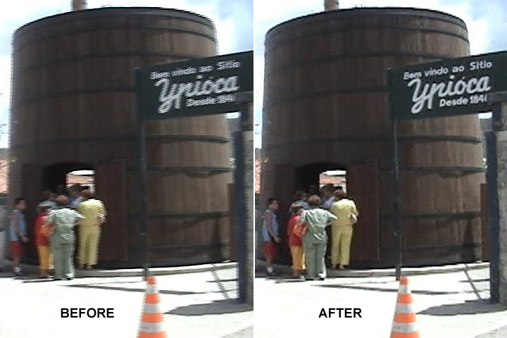

This is what you can typically expect by de-interlacing your stills in Photoshop. You can also do it with Elements and numerus other image editors:
As junkmalle pointed out, you'd be better off with a Progressive Scan Camera for what you want. For a low budget, you can use a camera that shoots in FRAME MODE like my Panasonic PV DV-953. It's not quite as great as a full res Progressive scan camera, but the images are interlace-free in FRAME MODE.
