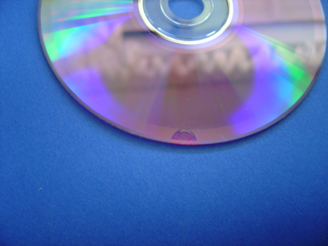

  6. The outer edge which is written last can be susceptible to problems like in this photo. This disk started to delaminate at the edge. If you look carefully, you can see the fresnel rings. This particular disk was an ESA dvd-r, X8 branded CMC product.

    Curious why it would get worse at end of movie???
    Because that's where the most unstable dye area is. Look at the photo above.
