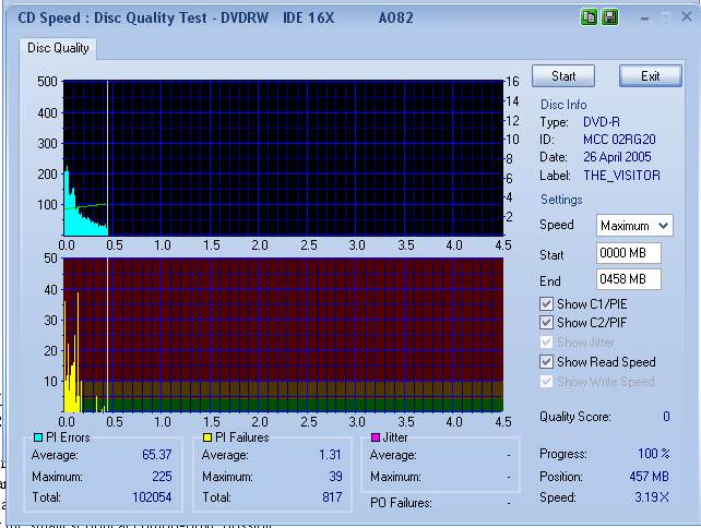

It did the test ok but take a look at this Disc Quality Test from Nero CD-DVD Speed.

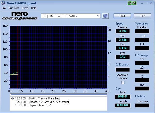

Do a transfer rate instead,run test /transfer rate and let it run all the way till the end.
I think,therefore i am a hamster. -
I did a transfer rate test, results below. I've relised that this is more complicated than I thought, since I upgraded my drives firmware, my pc thinks its maximum CD read speed is 8 (when its actually 42) and the max DVD write speed is 8 (when its actually 16). I'm almost certain I used the correct firmware. Could this be causing the 'stopping' problem on my burnt DVD's?
According to the graphs your burn is less than 500mb and its better to do a full burn and do a pi/pif scan at 4x instead of max,also the media is probably poor so buy made in japan brand instead.
