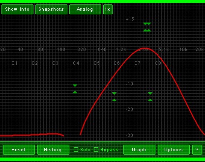

Even with a "perfect" source, your frequency and bit rate s are so low, it is going to be difficult to make anything sound great. Have you looked at Mp3Gain or WaveGain for file normalization ? I believe waveGain also has a built in limiter which is very fast.
Also, sometimes a bit of hiss is preferable to the overprocessed "wooshy" sound of a significantly denoised sound file.

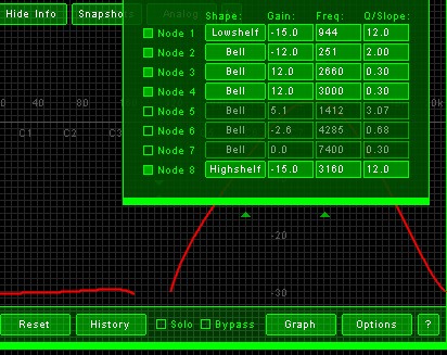

If I have a really horrible sounding source file, I'll apply a "telephone conversation" EQ to it, which does as it says, but it makes the overall sound much more pleasing. I'll check the eq settings if you are interested. It is a preset from a DirectX sound plugin I have. -
I'm not expecting to make it sound great. My main concern is improving the clarity of the softly spoken sections when the original is moderately noisy or worse.going to be difficult to make anything sound great.
Please let me know what the "telephone equalization" is. I can probably take that as a starting point ... and have a preset that isn't so drastic. -
Here's the phone effect on the original MP3, plus a ton of compression as the final "sauce". Dunno if you'll like it, but it sounds easier to make out to my ears.
speech-proc.mp3
This is what the phone EQ curves look like:
