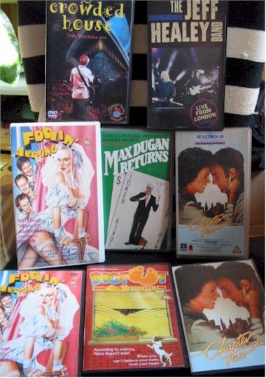

There is nothing naive about what you are asking...
All I can do is show you and tell you what I have done so far.
All of these in the above picture I have put to DVDR with my Philips PAL S-VHS machine via a scart cable from the VHS and into my Philips DVDR985 recorder. (It is an American NTSC model but also records in PAL as long as you use a brand new disc).
Some of the tapes do not have fancy DVD covers printed(created) yet but none the less...everything pictured has been copied to DVDR. What are the odds of ALL of these VHS tapes not having copy protection?..
I honestly do not know how or why it works....but copying PAL VHS tapes has never been a problem for me.
NTSC is another story however. I had to use one of these:
http://home.cfl.rr.com/filter/
to copy NTSC VHS tapes when I lived in America.
Edit:
Oh and it's not the VCR that is disabling any copy protection that may exist on the tapes...I also recently used my older Sharp VHS machine to copy the Crowded House video(shown in the picture) for my wife. Again using a scart to RCA(cinch) cable. My DVD Recorder just happened to be set up closer that that VCR at the time. -
