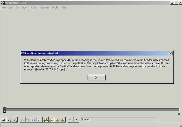

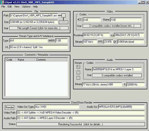

    Open file in GSpot to see what kind of file you're dealing with
    Open file in Virtualdub and click OK

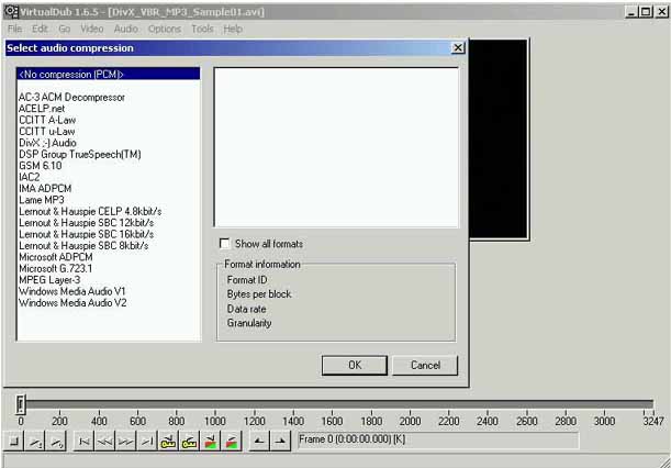

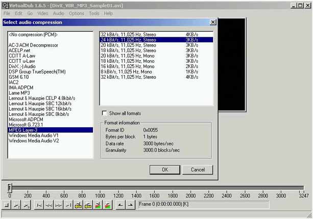

    Under Audio, choose Full Processing Mode and click compression
    Choose No Compression [PCM] and click OK

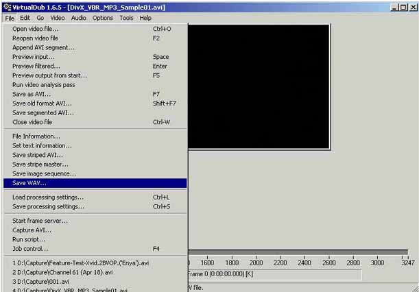

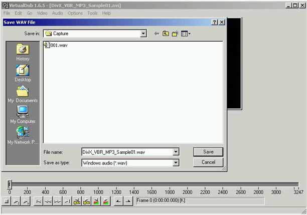

    Click File and choose Save Wav
    Choose a folder and name to save the Wave file to (preferrably your working folder)

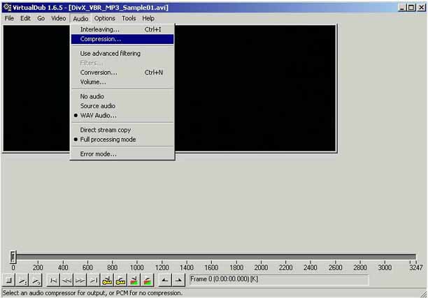

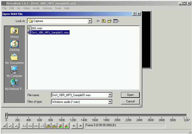

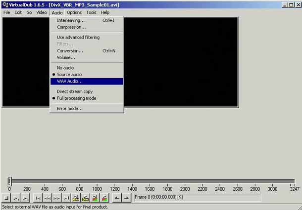

    In VirtualDub, click Audio and choose Wav Audio
    Find the Wav file that you saved earlier and click Open

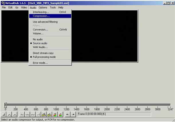

    Click Audio, Compression
    Select compression of choice

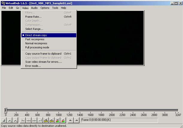

    Click Video, Direct Stream Copy

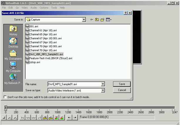

    Click File, Save AVI and choose the folder and filename you want to use

    This seems a rather long way round. I'd suggest taking note of the new CBR bitrate recommended by Virtualdub, choosing Full Processing Mode for audio, Direct Stream Copy for video. Then choose Compression (not No Compression as recommended here) and elect to compress using Lame to the recommended CBR bitrate. Write the newly commpressed audio and the original video out as an AVI with a different name and the job is done -- except that you might then have to adjust the sync using, say, MPC. But you might have to do this anyway using the longer intermediate WAV method suggested here.
