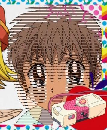

  5. What exactly do you mean by "interlaced artifacts"? Is it going to look like this? By that, I mean if it is interlaced will it always be this obvious? Will there always be two distinct overlapping images like this?
    I downloaded VirtualDubMod, but I've never used it. So, I don't really know what I'm looking for. I searched for "interlaced VirtualDubMod", but I'm not having much luck finding stuff. That picture was the only thing I found, and my files look nothing like that at any point.
    Jon
    P.S. I hope you guys can see this image. If you can't let me know.

    Well that is what interlaced video tends to look like. You can see it with motion. Like when someone is moving from left to right etc.
