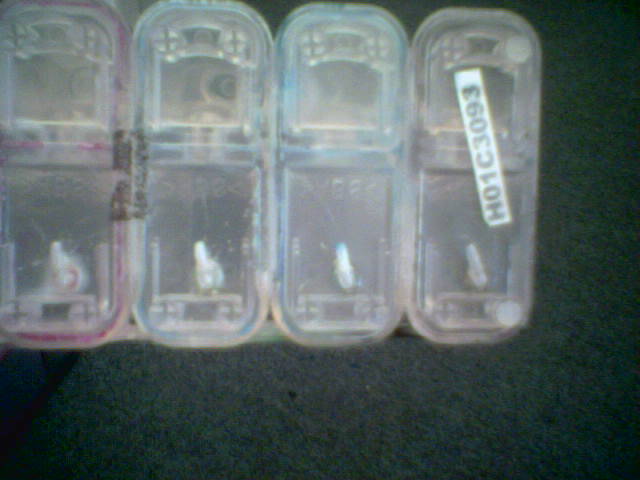

Anyone know if the connections for the tubes on top of the JLWsales cartridges can be turned? I need to change the direction of the tubes coming into the cartridge and keep kinks out of the tubes. The only way of doing this effectively is to turn these connections a different way.

Captain315: Looking at my old set, I doubt you'd move them without breakage.
Before trying it, look to an escape route if you do break any (check where you can get replacements.)
Depending where you are in the world, this could be easy or hard -- CIS parts are easy in the US, for instance.
A good source might be hobby shops selling model aircraft and other engine powered model parts -- the same fittings are used in their fuel systems (this is where early CIS developers got their parts) -- and medical equipment suppliers.
If you do succeed in moving the nipples, remember when you finally position them that all joints MUST be airtight. -
Sorry, I hadda run earlier and I forgot to post for captain315. No you cannot move the joints on the carts. They used a sealer that hardens when it dries and it makes the fittings stiff as well as airtight. Idle is right, You should find an escape route first but I have one question..... I used the jlwsales kit before and I had to take off the grey cart cover because it wouldn't close tight.... It's very easy to do and the printer won't give you a problem...Why don't you give that a try first? If you want instructions, post for it. I'm sure that most people on this forum wouldn't mind giving you the instructions, I know I won't mind....all you have to remove is two screws located on the front of the grey cover(near the reset chips).. You'll have to put the printer in cartridge exchange mode to get to the screw on the right side of the grey cover...after you remove both small screws you need to gently pull the grey cover upwards. You can lift it with your hand gripping through the opening of the grey cover. That's all it takes, Don't worry, Most cis kits(including printonadime) requires the removal of the grey cart cover.

I already have the cartridge cover removed Mac, thanks anyway. I appreciate the information about the sealer though. It appeared that they were not movable but I was unsure. I'm trying to re-route the supply lines to where they will feed from the left of the printer rather than the right side. That can only be done correctly if the tubes exit the right side of the cartridge carrier rather than the left as is standard with JLWsales CIS systems. There's a reason for this, it's just too long and boring to explain.

The direction of the tubing shouldnt cause any problem really. Ive run the printer for many prints with the ink tanks on either side before I settled on the right side. It seems to work fine both ways, I wouldnt sweat it.
