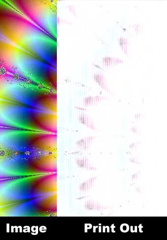

    I have solution they gave me and am going to try it.
    Do I just inject a small amount into the head and leave it? Do I have to suck it back up?
    Here is what I am getting right now as I print.
    Mar 2005
    Australia
    You've sure got massive clogs there!
    What you'd do is to inject the solution into the feed spikes, replace the carts and leave it a while — probably overnight, then try a head clean and nozzle check.
    You don't have to suck it back out — it should dissolve the hardened ink and flush it through.
    It might be necessary to run the treatment more than once to get it all, but usually once is enough.
    A couple of head cleans should get rid of all the solvent once the nozzles are clear.
