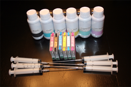

- Blunt needles should be used when filling refillable cartridges. Sharp needles can do a lot of damage (puncture, scrape, etc.)
- A good place to purchase refillable inkjet cartridges is www.printforless.tk -- as they have received much praise.
- Another good place to purchase refillable inkjet cartridges is www.printonadime.com

Have a good one guys... I'm off to go (finally) buy a refillable inkjet cartridge system! -

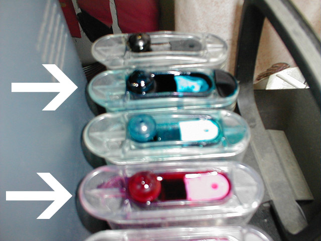

Thought I would chime in here with a little review for my PrintOnADime purchase.
I bought the CIS for my R300 off eBay and really got a good deal and no hassles.
I had emailed them prior to installing just to make sure i was doing things right.As many as 3 emails to them before installing and got replies fairly quick.
The CIS has been working fine and no problems anywhere up to a couple weeks ago.
It prints fine and really get excellent prints.The problem I have run into are the tanks overflowing with ink which if not seen could be a big mess.
The tanks have an inner tube that goes up to an outlet which you insert a small air filter.
Well these tubes have been filling with ink and started spilling ink out of the filters.Sometimes without even printing.I had even cleaned this mess once and had not printed and today I checked and just caught a big mess about to happen if not noticed.I could have had CYAN and MAGENTA all over by mid-day.
I have been in contact with the guys over at PrintOnADime and emails have been answered quickly and not once has any type of blame been put on my installing the unit wrong.They are sending out a new tanks and seeing if maybe I had a bad one.
PrintOnADime CIS seems to be good other than this issue I am having.I'm hoping it is just a set of bad tanks and once I replace them all will be good.
I bought the unit in Jan and filled it all up with ink and now down to half.So that might tell you how much has been printed.Doesn't seem like a long time or much to start having issues like this but it could just be a bad set of tanks.
For what I have personally gone through with this CIS and PrintOnADime, I would give it all a total of 8/10
Take away the issue I have now and I have been completely satisfied.
If you think about it, the only possible cause for this would be a build-up of pressure in the tanks.
Air leaking in via the fillers or a crack would only cause the ink level to equalise in the tubes and the tanks, not rise high enough in the tubes to be forced out the breather vents — which looks like what's been happening.
Are your tanks in a position where they could become warmer than the rest of the system — warm enough to expand the air inside?
If this happened, what you're seeing would be understandable.

Thanks for the reply.
I think I am seeing a design flaw in a few places.
Today I removed the tanks to install new ones I was sent by 'POAD'
When I removed the old tanks, I did notice a few things.One tank ( CYAN ) was leaking from the seams on front and back.I'm sure this is just one of those times that manufacturing was a little off.I am glad I caught it though before a huge mess.I only realized this because grabbing the tank left my hands very blue ( good thing I had rubber gloves! )
While I started filling up my tanks, I started with YELLOW.I did not fill it all the way full.I filled to the instructed line shown in the instructions.I then proceeded to put the rubber stop in and when I did this I saw ink rising up into the 'inner' tube and almost over flow into the 'surrounding' tube.This was my problem and why I relieved new tanks.
I had not yet inserted the air filter but it would not have mattered because it would have flowed through it anyway as it has been.
I'm seeing no reason to have this tube section in the tank.I think not having it and just add a small hole in the rubber stop would be enough for avoiding a pressure issue.
I also have seen other CIS tanks that have NO means of air vents.It is as if they are completely sealed at all times.I'm wondering if having air flow effects printing.Perhaps this air flow causes vacuum issues and creates clogs?
I'm wondering if I should make a complete seal on the tanks because the other day my YELLOW would not print out at all.Two days before it was fine then two days later no Yellow ink flows.Did head cleaning a few times and nozzle checks affirmed no Yellow ink flow.
I'm waiting for an email back on this latest from 'POAD'
Maybe I should ditch the 'POAD' tanks and use baby bottles!
Do not, for any reason, completely seal your supply bottles — even if you can't see it in some systems there must be a way for air to get in and replace the ink as it's drawn out.
If you seal them the ink flow will totally stop — you might even get backflow from carts to tanks if enough vacuum builds up.
The majority of CIS systems use a variant of the "Mariotte bottle" to ensure even pressure in the supply chain (with simple bottles the pressure will reduce as the level drops, thus needing more suction to lift the fluid column, with a Mariotte bottle it remains virtually constant until the level reaches the air transfer valve at the bottom of the breather tube.)
As with all such ideas, not all these things are created equal — properly done it's fine, made "on-the-cheap" it can pose problems.
For more on the Mariotte principle, a web search will turn up more and better information than I can give you here.
Re the yellow ink failure, if you haven't already done so I'd try re-priming the cartridge — most often it's caused by air in the cartridge itself, which usually you can't see.
The printer uses up the ink already in the space between the print head and the air, then ink flow stops.
Pull ink through until you're sure there's no more air — if you use a clean syringe you can put the ink pulled through back into the relevant tank.
Just a couple of weeks ago I replaced my CIS with one that had been on the shelf for about six or eight months — it looked fine apart from a few bubbles but the carts felt a bit light, so I reprimed all carts and was surprised by the amount of air they contained.
The system then printed perfectly without even a head clean (if the printer is turned off at the wall before the carts are changed it doesn't know anything has happened, so doesn't do a 'new cartridge' priming cycle) and has continued to do so — the bottles have now gone down about 25% and there are still no bubbles in the lines.
Had I not reprimed all carts I would certainly have had problems. -
Thanks for all your info.Much of it makes perfect sense while the rest is a no brainer and I should have thought a little harder on the subject!
First thing, the Yellow ink issue.I thought about that first but then figured no way no how and went straight to thinking clog.It makes more sense though what you have noted and I will re-prime the carts ( all of them since I am installing new tanks ) to remove any air.
The one problem I see with these tanks though are the design of the inner tube.I see no need for it really if you just use the rubber plug and have a small hole in it.The inner tube goes down into the ink so ink is able to rise up while the hole you put the rubber plug in is just that, a hole that ink does not reach up to so long as you don't fill the tank all the way up which is suggested anyway.So I think I will plug the inner tube section ( there are actually rubber plugs for them, you are just supposed to replace with the air filter ) and then I will make a small hole in the rubber plug allowing air intake.This way it gets the needed air flow while not overflowing any ink since ink cant reach.
Would you recommend this? You can see the design in my images a few posts up.Where you see the air filters, plug those up completely and where you see the rubber plugs, you will notice that there is what looks to be a hole.Well there is but it don't go all the way through.I'm thinking maybe have it go all the way through and I can have my air flow?
Another issue is the tanks themselves not very well sealed.They are two section pieces mended together but maybe not so good.I found a few leaks at seams on some.Who knows if these new ones are better sealed or not.I have yet to add any inks other than Yellow at this point until I know what I want to do.That meaning do I go with these tanks or try another method for the ink bottles? I'm not worried about ink wasting as I have plenty.My main concern is ink loss all over my computer work area!
Thanks for your help.

I wouldn't make a hole in the rubber plug — if you pierce the one in the main tank fill hole then you lose the constant pressure design and have to rely on the print heads to both supply enough vacuum to lift the ink when the tanks are low and prevent full tanks setting up a syphon and flooding the printer.
Piercing the one for the vent would be futile — the result would still be what you have now, but without the dust filters.
That inner tube is what the constant pressure design is all about (have a look at the Mariotte system & you'll see what I mean.)
I've used bottles of that general type for several years now and the system works fine — provided the bottles are properly put together (looks like yours may not be...) — there are a number of different patterns and sizes around, but the general principle is the same.
It's used in medicine for metering of fluids that have to be constantly supplied and accurate, and for many other purposes in industry and science — and it works very well indeed.
Shenhzen Microtec are probably the best known maker of CIS systems in China (probably because they make the most noise...) but by no means the only one.
And yes, so far as I know there are no longer any actual manufacturers of CIS systems in the US — nor anywhere else outside of Asia.
There used to be, but Chinese pricing has defeated them and those who are still around just go with the flow — either get the system or components as cheap as you can, sell cheap and keep your fingers crossed, or spend a lot of time and money researching the best parts and then all too often find the bulk supply you import doesn't match the sample you tested (don't ask me how I know this...)
Some suppliers do assemble sets out of parts sourced from various Chinese wholesalers, so they don't all look alike, but the majority do import them complete (often even already boxed) — hence the 'chinglish' instructions with most of them. -

As far as my setup being correctly installed, I followed the instructions to the 'T'
I fill the tank, no ink is seen in 'inner' tube.Soon as I insert rubber plug, I see the ink go up into that 'inner' tube and ink comes very close to over flowing.Doing a few prints does make the ink flow out the top eventually though.
I don't seem to understand how it is forcing ink out when it should be working on vacuum principal.It's like there is pressure build up and the only place for the ink to go is up and out.
