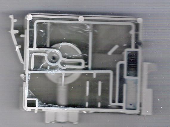

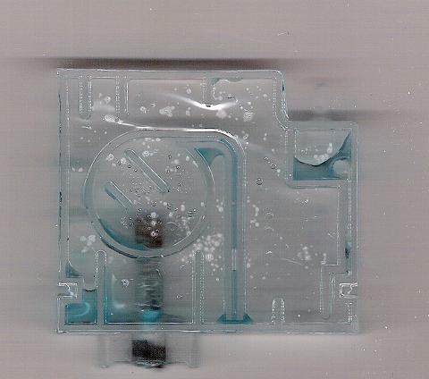

	For everyone that wants to know...you can tell if it's a valve in a cart by looking through the cart (if it's clear)and if it's a gray cart (not see through) look directly into the outlet port...you should see a piece that looks flat and smooth (usually gray or white) this is the plunger that closes when you take the cart out...don't disassemble the cart...it's not good for the cis kit!!!! and if all fails ask the manufacturer!! And Bidefordboy...No there is not enough room in the printer to install tubing or a cis unit...I've taken my R200 Piezoelectric printer apart and put it back together so many times i'm having nightmares that we're married(and we are)  Is what we learn indeed a fact, or someones opinon? Is what we learn indeed a fact, or someones opinon?
	Epson carts interior Is what we learn indeed a fact, or someones opinon?
	This is a real cis cart...clear and it cost $18.00 each... I used it to replace my cyan cart on the jlwsales kit while I waited for his replacement(2 weeks,15-20 E-Mails) the round center is what the printer uses to pressurize the cart it also contains the outlet valve Is what we learn indeed a fact, or someones opinon?
	it didn't upload .. Is what we learn indeed a fact, or someones opinon?
	clear cis cart $18.00 each Is what we learn indeed a fact, or someones opinon?
	sorry to post so much but I wanted you guys to see the pics...in the clear carts(not a good pic) you can see the round center going down you'll see the spring loaded valve(outlet)...this cart is dual printer capable..I didn't upload the case it comes with for the R200...it also fits the Epson C84 printer( the case is a plastic housing that makes it fit the R200/R300 printer models) In the jlwsales cis the cart is totally hollow...no chambers...and the round center(most important piece) is what the printer charges against for the ink...this piece also has the mechanical valve that provides an airtight seal and it closes shut to prevent leakage when the cart is removed  Another important fact is that you should not remove your cis carts unless it is totally needed...this will cause major problems with the nozzles(if air drys some or all of the residual ink on the cones)these cones are PIEZOELECTRIC ELEMENTS...and if you have the newer auto-reset chips(resets to 90%)donot remove the carts just before they reset because they will reset to 100% if you do!!! I'll explain the piezoelectric part later or you can look it up on google...do a search for piezoelectric printers
						Is what we learn indeed a fact, or someones opinon? Another important fact is that you should not remove your cis carts unless it is totally needed...this will cause major problems with the nozzles(if air drys some or all of the residual ink on the cones)these cones are PIEZOELECTRIC ELEMENTS...and if you have the newer auto-reset chips(resets to 90%)donot remove the carts just before they reset because they will reset to 100% if you do!!! I'll explain the piezoelectric part later or you can look it up on google...do a search for piezoelectric printers
	Macro, what would it look like if it were not a valve?
 I see a white piece in there but can't tell what it is. My cartridges have a sticker on the side, so I can't tell if it's clear or not. It says to not remove the sticker. Whats that all about?
	QLIZARD,Don't remove the sticker...underneath is a thin plastic film and if you break the seal your F**ked...the cart will be rendered useless....the film is a airtight....waterproof seal that withstands the charging from the printer....the carts your using are indeed a valved cart....mines are the same as yours (on the front it says"INKJET CARTRIDGE")...your good to go!!!! Is what we learn indeed a fact, or someones opinon?
	and qlizard the cart is gray...not clear...don't worry about it...your good to go...post any issues you have and contact the manufacturer about warranty Is what we learn indeed a fact, or someones opinon?
