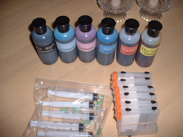

	like; i got the second set today (pics below) this guy sends quick! So far so good on the first set. About 25 cd's and ink is 3/4+ full. I am using my old ink til I run out.
 I am not that particular about color because I can always adjust output (stronger or lighter) and I mainly print cd's.
 As for the recharge cycle...I cannot say how many cd's i had to trash because the printer needed cleaning cycle, so i think it is a good thing ocassionally(to shut off then on). Also The printer seems to know when to do it, because I leave it on all of the time, and it ocasionally does it on its own, prior to printing. At least twice a week I shut it off and on. I think if i did not cycle as this, the ink would clog the head.
	poolenglish, why you change your avatar, you trying to blow my mind?  . Those are nice looking carts. Do they have a sponge in them? And do you leave one of the plugs out when you go to use them, if so, which one? Darn freight eats me up living in Hawaii, ON EVERY THING. . Those are nice looking carts. Do they have a sponge in them? And do you leave one of the plugs out when you go to use them, if so, which one? Darn freight eats me up living in Hawaii, ON EVERY THING.

 The side that is hollow is the side you fill and leave the plug off, after filling both sides. To refill ....you just fill the chamber side while in the printer, no cart removal necessary.
 It has foam in the other side,..... I think it is questionable of seller ads that say foam is bad, but time will tell.

	poolenglish, so the end that you fill is the one oposite of the orange tab & leave that plug off? Do you have to leave that plug off to print & then put it back in after you've done all your printing? And if you just leave it off, how do you protect the ink in that cart, either from evaparation or contamination? His online directions for filling those is confusing to say the least. There, it shows clamping some kind of clip on or over the exit port. I guess that would be to keep the cart from leaking while filling it. And if that is correct, do you get a separte clip for each color? I sure hope he sends better directions with all his products than what's on his website.
