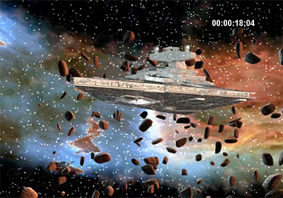

By the way, if any of you are curious to see the Xvid file encoded as it's been discussed here, please go to
http://www.lwg3d.org/forums/showthread.php?t=24404
...hope you like it.
