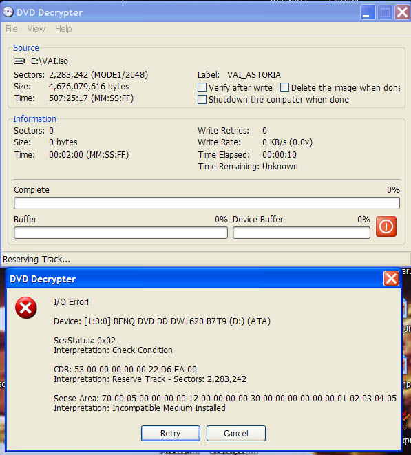

Ok..I bought a 100pk of these discs (Gold topped MXLG03) and my brand new BenQ 1620 with firmware B7T9 only recognizes SOME of these discs.
I have tried about 20 discs on this spindle and it has only recognized about 12 so far. Attatched is my DVD Decrypter error.
Thanks to anyone who can help me out here.

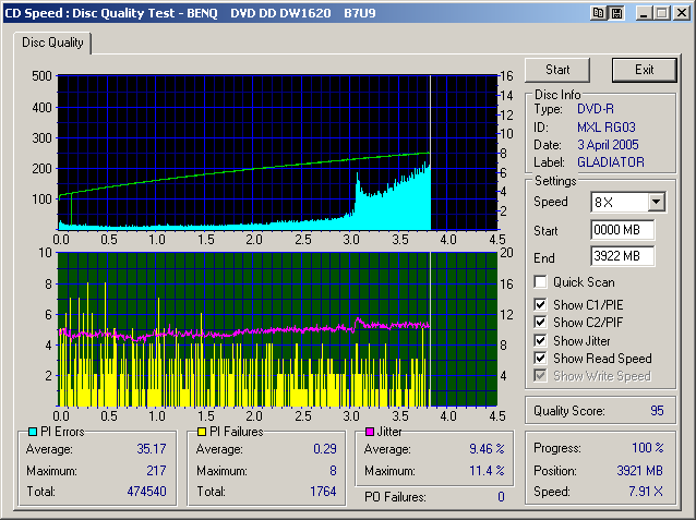

Well, I managed to find a couple discs that did burn at 8x.
Here is the scan of one of them....
8)
It looks like maybe I just got a bad spindle (actually a very bad spindle).
I may be able to salvage 50% of them...and return the rest. -

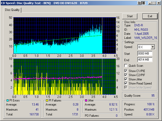

About 150 burned thus far on BOTH of my BenQ1620s without a single coaster and of the 30 or so that I've scanned, all are well within acceptable scanning specs. Even at 12X, I can manage to get only 8 PIF MAX and 95% QS. Moreover, I've used P9, T9, and U9 with basically equal quality burns.
So, in short, LS, it's the media -- not the drive.
- JIE
SCAN: 8X MXL RG03 @12X
(1)BenQ 1620 w/ B7u9 w/ MCSE speed patch
(2)Philips 8631 @ BenQ1620 w/ B7U9 w/ MCSE speed patch
GET MCSE HERE
BenQ Ownz j00 -

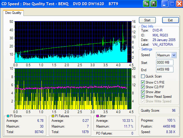

More evidence that it is the MEDIA, not the burner. See below, burned just now @ 12X MXL RG03 gold top.
I'm actually pretty impressed with that scan, much lower PIE than my other one @ 12X.
- Jie
GET MCSE HERE
BenQ Ownz j00 -

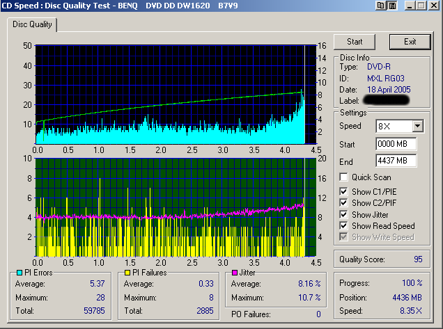

I did a scan with CD/DVD speed which I normally don't do but the MXLG03 discs have been probmatic to some. I burned a MXLG03 disc @8x speed with one of my BENQ 1620's that has firmware B7V9 but used the BENQ tool QSUITE called Q-Scan before burning the disc. I disabled WOPC feature as well.
richdvd can you return the MXLG03's you have? if you can try exchanging them for the DVD+R which are RICOH discs. Here's the download for QSUITE if you want to try it out here is the download for it: http://club.cdfreaks.com/showthread.php?t=130200&highlight=qsuite
