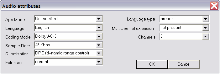

I cant remember exactly what I did, but try this. Use IFO Edit, open the VIDEO_TS file.
On the bottom window, double click the Audio for the TitleSet it is in. This should be the 6 channel audio. IFO Edit will state this, and make sure you have the following settings:
If it dont work, i will try to remember what I did and post back. -
