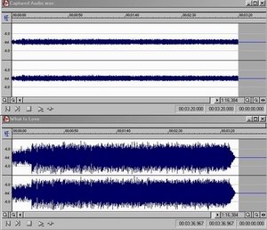

1. Load up the demultipexed audio from the video into your sound editor , again check on its Information selection as to its length , (to check against VirtualDubs answer) ,
2. Load up your ripped cd audio as well , then convert that to 48000khz before you do anything else (if you are making a dvd with it of course).
The two waveforms loaded up with totally different lengths (note the vhs cap has a very poor sound) .

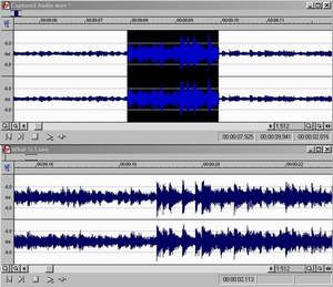

You firstly need a datum point - a snare drum , a bass drum or vocals in a recognisable point in the music . You find this roughly by listening to it , then zoom in on those two areas (start with the CD Audio , any drum beats etc will be much more easily seen on its waveform , they are very distinctive ) .

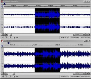

3. If your sound is poor then either side of this point Normalize it (as in top waveform in picture above - locally Normalizing it helps keep everything visually in place) , then it will be easier to relate to the cd waveform .

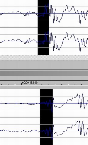

The two sections of the 2 waveforms look quite similar now (see above) , zoom in again , narrowing the highlighted section to the start of the drum you can see kicking in . Zoom in as much as you can and still see the waveforms .

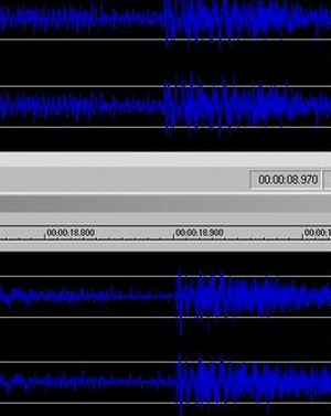

4. You can see the datum point to make - at the start of the drum beat (see above and below for zoomed in ) , click on the bases of the drum beats waveforms and note the times down on the two waveforms .
This pic above shows the same section , normalized and , ready to click on the start of the first peaks to get the times .
