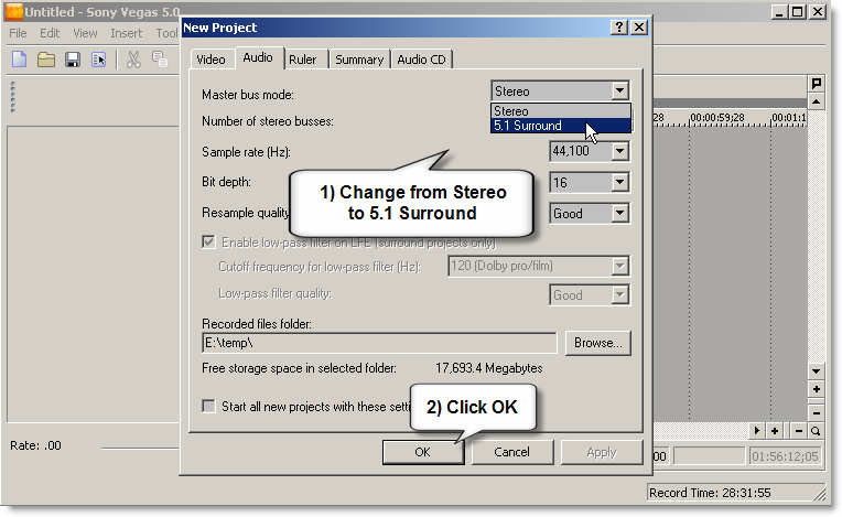

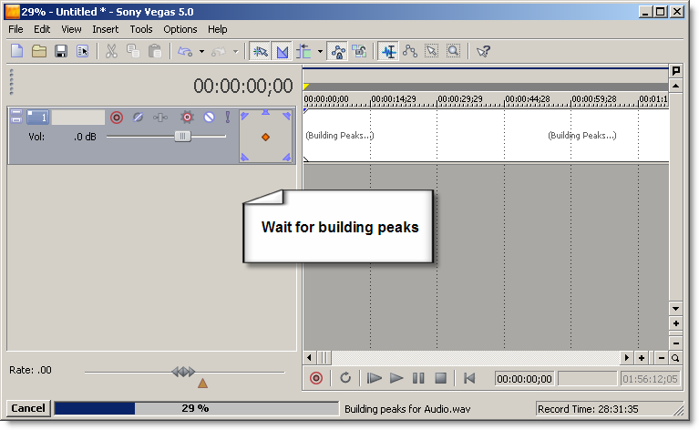

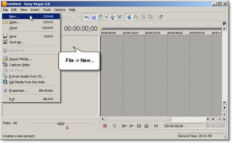

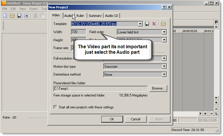

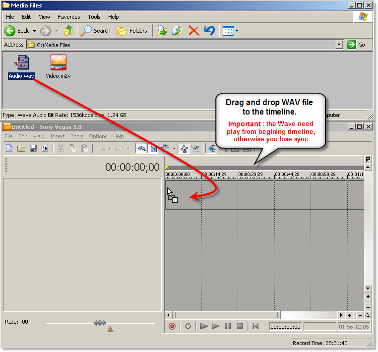

Converting WAV file to Dolby® Digital 5.1 Surround
Using tool Vegas 5 make 100% DVD compliant 5.1 Surround AC3 files.
Important note: to enable Dolby® Digital plug in Vegas 5
you need purchasing DVD Architect or ac3 plug-in
In this guide I convert 2 channels WAV file to 5.1 Surround AC3 file to hear in all speakers not only in front speakers.
The configuration of the Dolby® Digital plug
To convert from Dolby® Digital 2.0(2 channels) to Dolby® Digital 5.1 Surround,
you need convert AC3(2 channels) file to WAV (2 channels)
for guide without losing sync and quality click here.(TMPGEnc Sound Plugin required)
