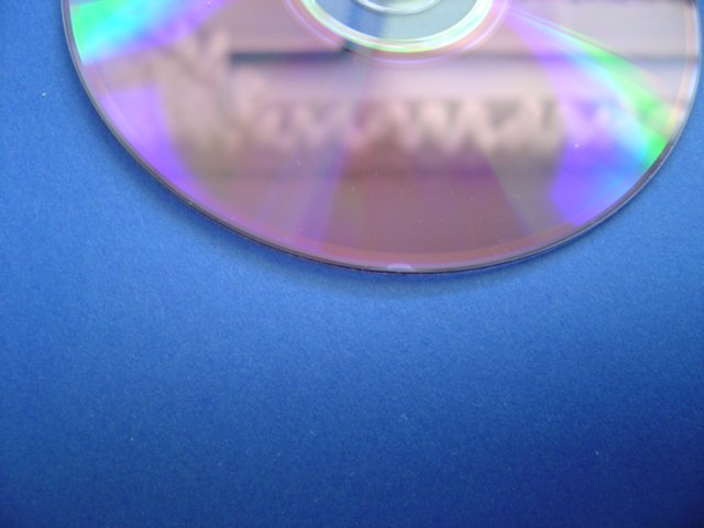

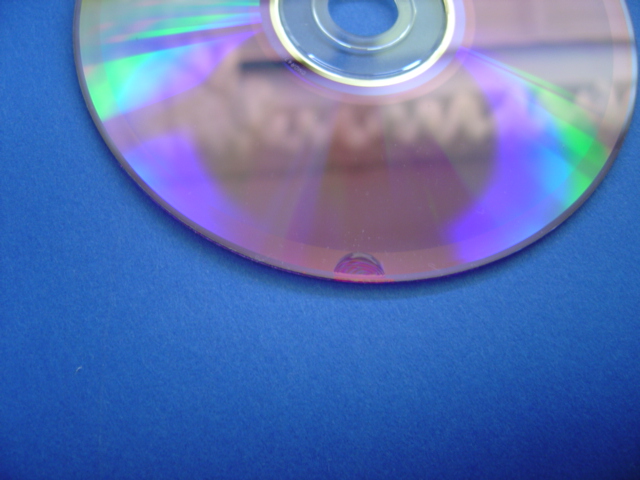

My distain for Ritek media is no secret, but this morning I noticed something else on those previous backups I did last year, I had never noticed before. Whilst running my finger around the outer rim of the Riteks, they have "dimples", serated edge, like a circular saw. Whats more, they are irregular in spacing, and when veiwing the dye side under strong light, there is a "stress line" radiating towards each dimple. Weird !
I checked all my Riteks, and some Maxells (Ritek G04's), and they are all the same. Some have just a few dimples on one place. Its like they were punched out with a blunt instrument.
Anyone else noticed this ? Check your discs.
These "dimples" on the outer rim would surely throw the dvd out of balance, could these dimples be the source of the infamous Ritek problems ?

I always thought it was the glue seeping out a bit that keeps the two layers in contact.
This is nothing new, alot of media has similar edges. They 'surely' don't throw my Ritek discs out of balance nor any of my other media with 'rough' edges, I haven't had problems with Ritek media or other media with similar edges. In fact most of the best media I've used has rough edges, including RICOHJPNR01 discs. In contrast, some of the most problematic discs I've ever used, Princo and Optodisc, have smooth edges.
So no, your theory doesn't hold water. -
It's glue and plastics.
The only media that I know of that have clean edges are MITSUBISHI and PRODISC media. Just better equipment making the discs.Want my help? Ask here! (not via PM!)
Yeah guys, but here we have all read the reports of labels slightly off centre throwing discs out of balance, so how can irregular/random blobs of plastic on the very rim, the most vunerable place, NOT cause such problems ?
And incidentally, I have only seen this on my Riteks, not on any other brand. -

Interesting that anyone would mention the rough glue edges on some media. I found this to be somewhat of an issue with two Toshiba standalone recorders I tried. It rejected 90% of all media I tried including Taiyo Yudens. It was able to load and burn several previously rejected disks after I smooth the edges with a file. Needless to say, I returned both Toshibas and am now happy with my Pioneer.

It is possible to have problems with almost any brand and any supplier. Just carefully inspect the product before using it. Here are some samples.
ESA brand dvd-r, 8X disk, id's as CMC. Delamination is occuring at the lower edge as the fresnel lines show.
Taiyo Yuden, dvd-r, 4X disk. This problem looks like a chemical etched the surface of the disk at the lower edge. You can feel the roughness with your finger.
