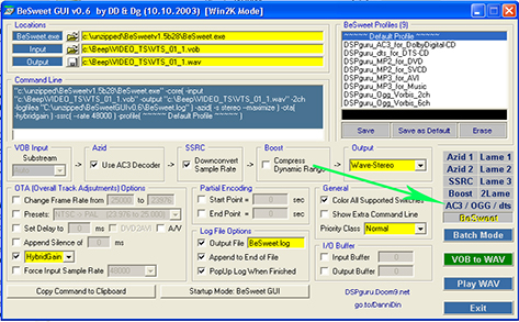

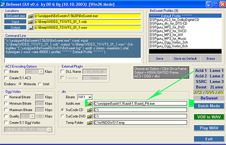

On the other hand, I really don't know why you get these errors with BeSweet. Did you install the right audio codec? Here are some images: 1st one is BeSeet's main screen, please select the option pointed by the green arrow. Now check out the second screen. Does that box show the codec there (green box)? Hope this helps.

Sorry I wasn't at home when I replied the last time. Looking at the pic you've uploaded, I've noticed that your BeSweet version is newer than mine. Look at the bottom of the screen, on the right; it's written Actions (under BeSweet). Have you ever tried to push the button DTS to MP3?
About Azid 1.9 - it's funny because I can't find Azid around here anymore. Maybe it comes along with BeSweet. Anyway, I've found a website "en français" where you can dowload Azid. It says télécharger that means download - I'm sure you know that. Please push that button before. If nothing happens, try to unzip Azid and tell BeSweet where the Azid.exe is. Hope this helps.
