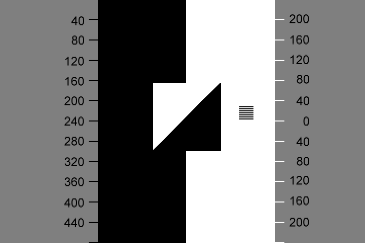

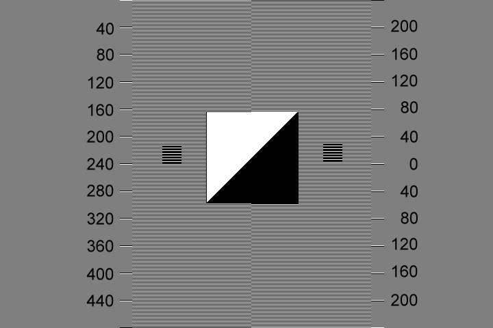

  18. Originally Posted by vhelp
    From my understanding and researching, when you pause a frame from your
    dvd player or vcr, and you view the image, ..when you see a fluid and clean (non-interlaced) screen, you are not seeing a fluid and clean screen. The screen is showing your source interlaced, but at 60 times a second, so fast, that you can't noticed it as interlace
    I don't know about your DVD player(s) but every player I've owned performs a drop frame deinterlace when paused. They either display the same field twice or replace the second field with data interpolated from the first.
    If you want to test your player(s) burn this test image (do not deinterlace, deflicker, or resize) as a short video on an interlaced 29.97 fps NTSC movie DVD:
    When you play it back on your NTSC DVD/TV it should flicker like crazy. When you hit pause you will see something like this:
    The black and white halves may be reversed depending on which field your DVD player drops.
    I can provide a DVD ready MPEG file if anyone wants it.
