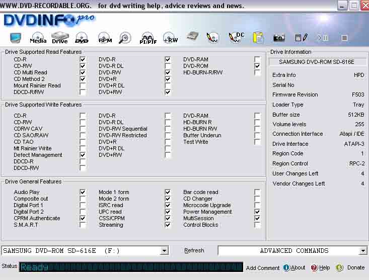

    i would use dvdinfopro on the dvd and try and find out exactly what type of dvd it is
    does it play on your PC
    Jul 2004
    yes it plays on my computer. And I ran it through DVDinfo and came up with the image.

    presss the media button and post back that image
    Thats info about your DVD-ROM

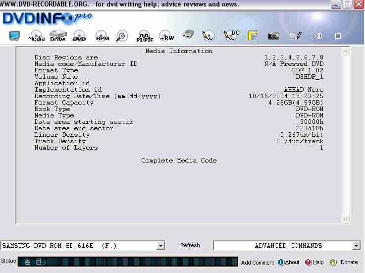

    Jul 2004
    Sorry here is the stats:

  11. Its not a DVD9 its a DVD5 and it was authored with Nero. Its a bootleg.
    Throw it out and buy the real thing.

    It is an all-region DVD-R & should therefore play in any domestic player. Notice where it says number of layers? Only one layer is indicated, which means it is a DVD5. If you have a DVD-writer, rip it & burn another copy.

  15. Shocker Milwaukee, its clearly stated by the info that its a real DVD-ROM. I have a few similar from Philippines. It would be WAY too expensive to use DVD-R when SE Asia is full of DVD-ROM production lines. The anti-piracyguys estimated that Philippines alone had a production capacity of 100 million DVDs per year in 2003, not counting the ones doing legal stuff. That number is much higher now i believe, but still not very high. The reason the number is so low compared to the population is that most peole in SE Asia still use only VCD, and pirated VCDs are sometimes burned, DVDs not.
    @thor3000
    I saw the same thing (media type=DVD-ROM), but the post I've quoted above points out that the implementation software is AHEAD_NERO, which suggests to me that it was burned. Also, DVDHelpPlease indicated that the artwork on the DVD itself states that it is DVD-9, when in fact it is a single layer disc. I figured it was a one-of knockoff printable. I certainly could be wrong about that, but my suggestion (to rip & burn a copy) is certainly still valid.

  20. shocker milwaukee, I guess the one who authored the movie for DVD just used Nero and then burned some copies on DVDR that was sent to the productionline. Its a reverse DVD backup; DVDR to DVD

  24. shocker milwaukee, I guess the one who authored the movie for DVD just used Nero and then burned some copies on DVDR that was sent to the productionline. Its a reverse DVD backup; DVDR to DVD
    This makes sense.
